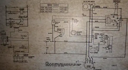

Note: the below was solved. It was a loose wire between the controller and the gas valve (the white wire on the diagram)

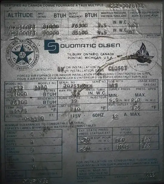

This is about an old UltraMax Olsen HCS2 81AD gas furnace enter image description here it looks like this enter image description here and it sounds like this :-) when it is having problems

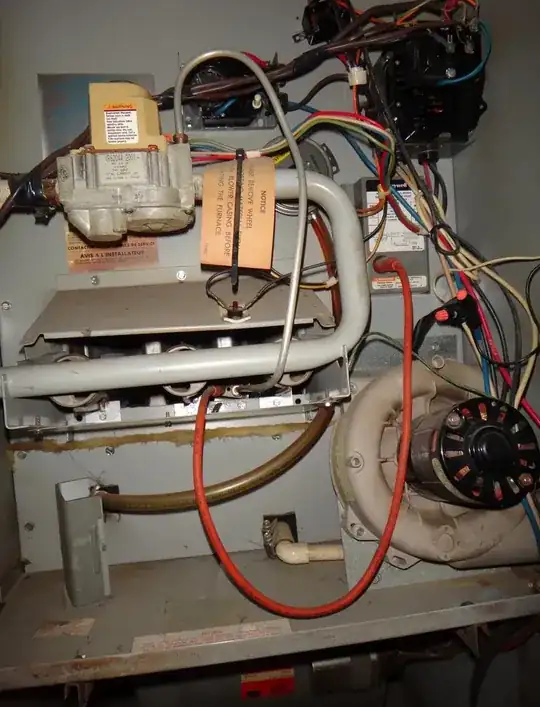

Here is what happened this morning. I waked up hearing the a noise that was coming from the furnace. I wend downstairs to the furnace room and it was making a sound like this (click to download a small mp3). I switched the furnace off and I went upstairs to get my phone to take pictures and record the sound. When I returned I tried to start the furnace one more time and it started. It worked for a little while and it stopped again making the same sound I switched the furnace off again and went upstairs to read a little bit about it (we bought the house this summer and I don't know much about it) and when I returned I started the furnace again. I think it worked again till it reached the temperature set on the thermostat and it stopped again making the same sound.
I am now waiting for it "to rest" :-) and I will start it again but with an increased temperature. It was set to 21.5 before, now it is set to 23 ..I want to see what it is going to do this time
