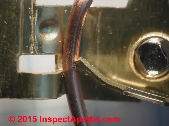

Do you see the connection? Two thin edges and and one of them where there is damaged wire. This can create hot spots that are invisible outside of the device. As the metal heats and cools over its life time the connection and become weaker making it get hotter.
Compare this to wrapping a the wire around a screw, which tightens up as you tighten the screw. Anyone can visually inspect the latter while the above picture you would never see. I myself use pigtails when connecting devices whenever I can. This way if there is device failure it is localized instead of taking out the rest of the circuit.
