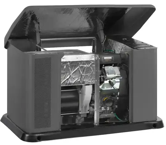

If this is not a temporary power situation, you might consider a whole house standby generator. The deluxe units switch to generator power not only when the voltage goes low, but also when it goes too high. enter image description here
