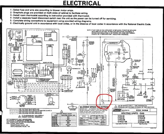

UPDATE: I've added the wiring diagram from inside the furnace.

Lennox terminal block inside the furnace uses T label on the terminal block for common, as shown in your electrical wiring diagram.
