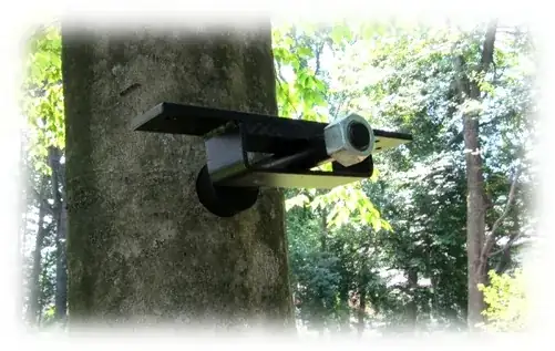

You certainly won't want to just sit the beam in the fork of the tree. The tree will move quite a bit and you'd slowly wear through the bark and damage the tree if you do that. Also note that forks aren't always the strongest part of the tree.
What you want to do is have the beam mounted to the tree with hardware that a) allows for lateral movement and b) is offset from the surface of the mark.
They make special hardware just for this. It's typically a huge lag bolt with a spacer than the beam 'rides' in via a slip bracket. Example:
source: http://www.treehousesupplies.com/1_25_Floating_Bracket_p/br-f1.25.htm
DA01

  • Would an inverted half cut tire on the tree crotch alleviate your concern of tree damage? – statHacker Jan 05 '15 at 12:20
  • @statHacker you could try it. My concern with that is that a tire has a lot of friction and I don't know that it'd let the beam smoothly move back and forth over it. – DA01 Jan 05 '15 at 14:36
  • Do you think the beam not being able to move smoothly would cause a great deal of forces on the rest of the treehouse? So by using the tire we increase protection of the tree but also increase the risk of the treehouse falling down earlier in its lifespan? – statHacker Jan 05 '15 at 18:32
  • @statHacker trees are meant to move. Restricting their movement can add undue stress to other parts. It's not the treehouse so much as the tree I'd be worried about. Today's treehouse hardware is all designed to ensure the tree can move freely (which, in turn, will help avoid transfer of stresses to the tree house as well). – DA01 Jan 05 '15 at 19:08
