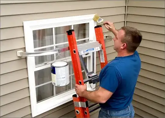

Don't do it. Put the ladder above the window, then clean by putting your arms through the rungs.
Shouldn't the windows have a way to tilt them inward and clean from inside the house? Most every modern window I've seen has a way to do that.
You may want to get a ladder stabilizer: enter image description here
Ariel
  • 1,873
    They are fixed pane windows. They are high above and decorative. Haven't you noticed the sizes? They are very big. – Luiz Borges Jan 06 '15 at 23:17
    I did notice the sizes. Is it one enormous sheet of glass? Or several windows side by side? You put the stabilizer on the frame in between panes if there is one. If not, you can use the stabilizer above the window, not to the sides of it like in the picture. It gives you a bit of offset that will make it easier to work on the window. – Ariel Jan 07 '15 at 01:01
    OK who is really buying this? – DMoore Jan 07 '15 at 05:19
    @DMoore I would assume Luiz Borges would buy the stabilizer. I'm not really sure what you are asking. Did you post in the wrong place? – Ariel Jan 07 '15 at 06:40
    Painting a window without paint on the brush. lol'd a little. – jawo Jan 08 '15 at 10:59
    @Ariel - it is just a goofy thing to buy. Maybe if you were a pro painter you might have one - yet I have worked with 20 painting crews and never saw this. Let's just say I am not buying stock in the company producing this. This particular guy with invisible paint could have scooted the ladder over 2 feet either way and been fine. – DMoore Jan 08 '15 at 14:47
    @DMoore You are misunderstanding the use of this. It's not intended to span windows (even though it can). It does two thing: Stabilize the ladder! That's its main job. And secondly it pushes you a bit away from the house, making it easier to work at the very top of the ladder. The companies that make it are the ladder companies - they are ladder specific, it's not a 3rd party aftermarket product. – Ariel Jan 08 '15 at 17:01
