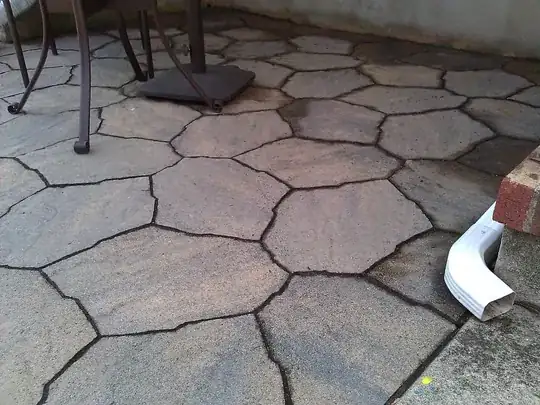

I just completed a 90 square foot patio. I ended up putting down 4 inches of paver base (crushed concrete), 1 inch of sand, and then the 2 inch patio stones... so I dug down 7 inches all around. To be honest though, I went deeper than that in some places and ended up having to bring in much more paver base (crushed concrete) than I really needed. So maybe I have 6 inches of paver base in some areas. In my opinion, the key was the compacting. I highly recommend you rent a plate compactor. You should be able to rent one for less than $100 for 4 hours and it is completely worth it. You will only use it for 30 minutes but it will make the crushed concrete as solid as rock.
Also one of my neighbors who is a landscaper joked about how far I had dug down... he said I went way too deep and now I can land a helicopter on my new patio. I tend to agree with him that the 4+ inches of paver base was more than needed but still I am happy with how it all turned out.

Updated with photo for @Chris Marasti-Georg (2013-05-20): enter image description here

  • @JeffWidmer Did anything end up growing through the patio? – Chris Marasti-Georg May 20 '13 at 13:30
    @ChrisMarasti-Georg Nope, nothing. No cracks either. I added a picture for you. – Jeff Widmer May 20 '13 at 18:53
