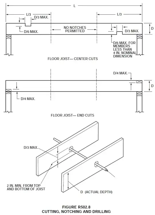

I already know that a hole bored in a sawn lumber joist cannot be within 2" of any edge or any other notch or hole. And that the hole can only be a maximum of 1/3 the depth of the member (International Residential Code 2012 R502.8). Given all this, is this a code compliant joist?
Bored Joist
For more detail on the code used to determine the dimensions mentioned above, see this answer.
After doing more research, I've found sources that recommend not placing holes closer to each other than the maximum hole size. For example, in a 2x10 holes should be at least 3 5/64" away from each other.
Bored Joist holes max size distance spacing

If there is nothing in the code of practice which specifies a limit to the number of holes, then there is no limit to the number of holes.
From an engineering standpoint, this is because a beam with holes in it can act like a truss (see e.g. the bailey truss). The minimum hole sizes and minimum spacing is to allow enough timber to act as the vertical/inclined "truss elements". Therefore if it is ok to have two large, closely spaced holes at any arbitrary position along the beam, then it is ok to have holes of that diameter and spacing the whole way along the beam.

Structural engineer here. This answer is late, but better late than never.
Notches (cut-aways from the edge) have more requirements due to the flexural (bending) nature of beams: the upper and lowest most fibers of the wood member take the most stress and control the design strength of a beam. See the figure linked below for specific requirements, taken from the IRC.
While the hole locations are less strictly controlled in the IRC, you want to avoid them in the outer ~1/4 of the joist span, as that is where the maximum shear occurs which is designed using the bulk of the wood material, not just the top and bottom fibers like in flexure. I don't think this is codified anywhere, but it's a good rule of thumb.
In summary: Holes should be limited to D/3 in the middle (1/2) of the span and I would limit holes to 1" or D/8, whichever is smaller (this is not codified, but is reasonable), for the outer (1/4) of the span. Holes should never be outside the middle (1/3) of a member. Weyerhaeuser recommends 2x[Hole Diameter] minimum clear distance between holes for their TJI products, which would be a conservative rule of thumb to apply moving forward. I also wouldn't drill holes above each another.

    Professional input is definitely welcome! To address the question specifically, as I read your answer, it would be OK to bore a series of holes meeting the `D/3` size guideline, spaced `D/3` apart, in the center 1/2 of the joist, while a series of 1" max holes (spaced a minimum of ?? apart) could be bored in the outer 1/4 span. Is that correct? It would be good to [edit] that into your answer. – FreeMan Dec 08 '20 at 19:09
