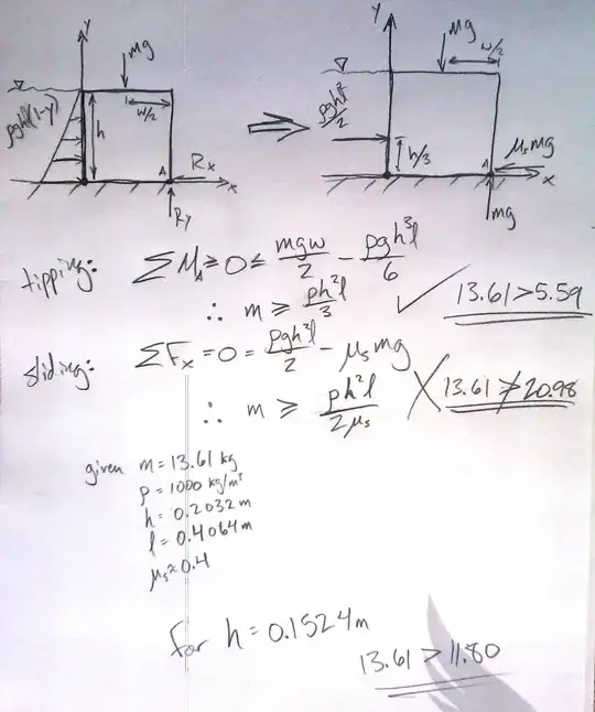

I did some quick calculations and got the following: enter image description here
So to sum up my incoherent scribblings, assuming a 30 lb cinder block holding back 8" of water and a coefficient of friction between the ground and the blocks of 0.4 (which I think is conservatively low), the blocks will not tip, but they will be pushed backwards by the hydrostatic force.
Reducing the water level to 6" results in the wall being able to withstand the hydrostatic force by a small margin. Even so, you'd be risking high water conditions after a heavy rainfall destroying your wall. It will need reinforcement. You could do that by pouring concrete into the voids and increasing the weight of each block to greater than 46 lbs. You could also drive a rebar stake on the inside of each block against the side holding back the water.
NOTE: I did quick calculations and made a lot of assumptions. This answer is an estimate and should not be considered professional advice. (Translation: Please don't get pissed off at me and track me down if your pond floods your yard.)

  • @Jim: Figure 2 shows a sloped upstream dam surface with a stabilizing downward force from the weight of the water column above it. I didn't read your question well enough on my first pass - I was thinking of a stacked wall of several shorter blocks. Making the bottom row protrude halfway into the pond side and using a half block on the outside would have a similar effect as in the drawing, as long as mortar was used to join all the blocks together. – Doresoom Apr 20 '11 at 19:43
