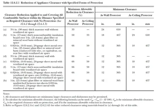

According to NFPA 211 Standard for Chimneys, Fireplaces, Vents, and Solid Fuel-Burning Appliances, you'll start with 36" clearance all the way around.
Figure 12.6.2.1(b)
Then you can use one of the methods described, to reduce the required clearance.
Table 12.6.2.1

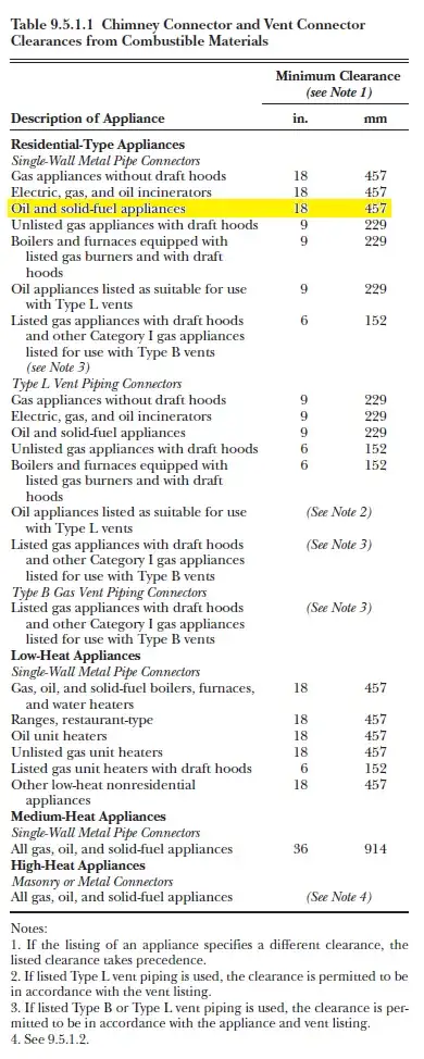

As for the connector, you'll start with 18".
Table 9.5.1.1
Then apply any reductions.
Table 9.5.1.2
