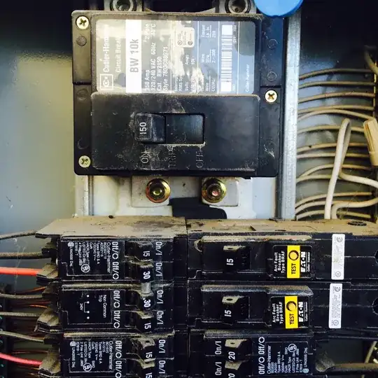

I am looking into installing a sub panel in my basement which will be used to feed electrical circuits to the basement that is currently unfinished. I have an 150 amp main panel and was thinking of installing a 90-100 amp sub panel. I do however have a few questions:
1) Since I do not have any breaker space, I am wondering if there is anyway to replace breakers or shuffle things around to make space? I've included a image below of my panel if it helps anyone make recommendations.

  • Can you post a photo of the panel directory? – ThreePhaseEel Feb 12 '15 at 03:41
    Holy crow, that's a packed panel! Is this a large home, or is each receptacle on its own breaker? I've seen panels full of regular breakers, but never one full with tandem breakers. Seeing that suggests that maybe you should do a new load calculation (including the new loads in the basement), and see if it's time to upgrade the service. – Tester101 Feb 12 '15 at 13:24
  • It is a larger home with lots of circuits so i'm not too surprised that its full. – Cory Feb 12 '15 at 15:55

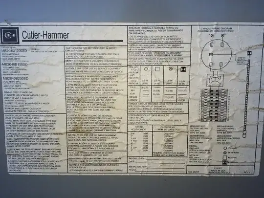

  • Looks to me that there's nothing wrong with it and it was probably done intentionally to avoid a larger panel - maybe. It's really a guess to why but based on the catalog # it looks like not only is it fine, but you could add some more too, which would then give you the space for the other. IIRC, MB2040B... "says" 20 breakers (that's obvious by counting the single spaces) with 40 circuits which means the entire thing is designed to have tandums. – ChiefTwoPencils Feb 12 '15 at 21:03

  1. You can do this without moving any circuits by replacing the 20A tandem breaker in slots 10/12 and the 30A two-pole breaker occupying slots 14/16 and 18/20 with a 20A/30A quadruplex breaker with a center common trip which will take the circuit from the 30A breaker and independent, non-tied outer trips that take the circuits served by the 20A tandem breaker -- in your case, the Eaton BQC2302120 -- and then shifting the two 40A two-pole breakers (one is in 22/24 and 26/28, the other is in 30/32 and 34/36) on that side up a full width slot (so that you would have a quadruplex in 10/12 and 14/16, the first 40A two-pole in 18/20 and 22/24, and the second 40A two-pole in 26/28 and 30/32). This would then leave you with slots 34/36 and 38/40 open to put your feeder breaker in, which of course must be an Eaton BR two-pole.

  • According to the panel, that 30 amp breaker feeds our AC. and the 20 amp unit feeds a fridge and bath GFI. As an aside, any recommendations on the specific panel to use? I know if I buy one that is purposed for a main panel I need to make sure to isolate neutral from ground by removing the bonding screw/strap. – Cory Feb 14 '15 at 04:18

  • Regarding your comment on independent trip breakers, I just realized the existing one in spaces 1,3,5,7 is indeed an independent trip breaker which feeds a dryer and master bath/study. Does this mean it is in violation of code? Or perhaps the code changed? Home was built in 2006 – Cory Feb 18 '15 at 21:10
  • @Cory -- considering that your dryer is a 120/240V load, it *is* a Code violation! Replace it with a BQC2302115 while you're at all this. By the way, do you have a local electrical supply house you can order parts from, or are you limited to what the blue borg stocks? – ThreePhaseEel Feb 18 '15 at 23:14
