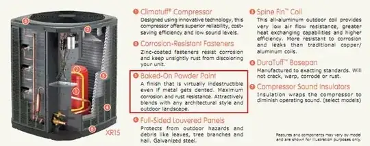

The Trane unit has a special coat of paint that will make it look good for years and years, I doubt you will need to wax it.
Even if it is powder coated, it could still rust. The odds of this are slim though, as it would have to be knicked in a spot to start to rust. – Evil Elf Nov 22 '11 at 18:28
