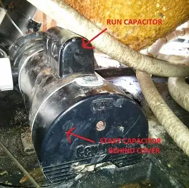

Update 1 Replaced the capacitor and it ran for a short while but stopped again. I've removed the pump and will test it on a bench.
Update 2 After pulling the motor out I confirmed that the impeller could be easily turned by hand, so it wasn't jammed.
Chris Vesper
  • 814
After pulling the motor out (which required draining the spa and disconnecting the PVC connections) and removing the cover, I found another capacitor. Googling the part number indicates that this is a start capacitor. It helps the motor start.
The motor also has a capacitor on the outside, and it's the run capacitor. That's the one that was replaced first.
After replacing the start capacitor, the motor started and is running.
http://en.wikipedia.org/wiki/Motor_capacitor
It turns out that Spa/hot rub AC motors like this have both a start and run capacitor, as do blowers on forced air furnaces and air conditioning units. If an AC motor like this won't start, there's a good chance it's the start capacitor. The start capacitors tend to fail eventually, the run capacitors last much longer, apparently.
My spa motor
Spa motor
Start capacitor
Start capacitor
Run capacitor
Run capacitor
