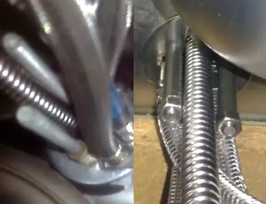

I had an idea that worked for me. I made spacers from steel brake line, and used a socket to tighten the nuts in a more convenient place for me.before and after
