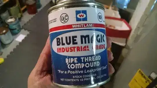

This is what my plumbing supply house sold me to attach a 3 inch PVC threaded fitting into cast iron pipe.

My personal preference is pipe dope instead of Teflon tape every time unless doing low pressure flared tubing. Teflon tape only works if applied properly and that seems to be an issue a lot of the times. Pipe dope you coat the threads and it fills in the areas as you tighten. Yes it can be messy but having to go back because of a leak can be very costly. Coat the threads of the pipe not inside the fitting and wipe off any excess. I have installed and repaired air, water and gas piping for the last 20+ years and have found that the majority of the leaks issues have been Teflon tape installed incorrectly.
