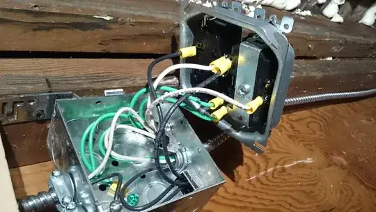

As the title states, are there any code restrictions in general on using crimped spade and ring terminal connectors when wiring household electrical circuits?
I've actually been doing this for a while, using 600V rated spade connectors from Home Depot, and Wago's Wall-Nuts, and I've inspected some of my work that has been installed for over a year and saw nothing worrisome but I thought it might be good to ensure I'm not totally violating code here.
An example of something done recently: enter image description here
EDIT: I predict a lot of "you don't need to do that" or "that's overkill" replies: Yes, that's totally obvious, but I like to over-engineer things.

  • can't answer specifically to code, but your installation seems unusual. I presume that wire is stranded? If you are using solid wire, it would be better if you just wrapped the wire around the outlet's screw and tightened it. – Edwin Mar 19 '15 at 05:51
    Yes it's all stranded. I prefer stranded, as #12 solid copper is quite difficult to move when pushing the device back into the box. Stranded costs more, but it's much easier to work with, and I feel it gives a better end-result which is why I've been doing it this way. – William S. Mar 19 '15 at 05:54
    Since you're working with stranded wire, it's actually probably a good idea that you're using these connectors. I doubt there's a code issue here. If the terminals are not designed for such connectors, it *could* be a violation because you'd not be following the manufacturers installation instructions. Make sure you're using the proper sized connectors, and you shouldn't have a problem. – Tester101 Mar 19 '15 at 12:40

  • What I would do, instead of using the crimped connections is use solid-wire pigtails. Then, you could wrap the solid wire around the screw terminal and tighten. It would be more secure, imho, than the crimped connectors. – Edwin Mar 19 '15 at 15:47

After further review, it appears that receptacles and switches are listed for use with crimp terminals. So this installation would not be a violation of NEC 110.3 (B).

  • Apparently, not all outlets are identified for use with crimped-on ring or spade terminals, even if they are listed under UL486A. It makes me wonder if the verbiage from the White Book you quoted was intended to apply to proprietary "modular wiring device" connection systems (Arrow-Lock, Lev-Lock, PlugTail)... – ThreePhaseEel Mar 24 '15 at 22:29
First point: your terminals need to be listed under UL 486A in order to be usable in household wiring; many are, but some aren't, so check the package for the solderless terminals you are using!
Second: provided the terminals are listed for the application, NEC 110.14(A) also applies here:
Terminals. Connection of conductors to terminal parts shall ensure a thoroughly good connection without damaging the conductors and shall be made by means of pressure connectors (including set-screw type), solder lugs, or splices to flexible leads. Connection by means of wire-binding screws or studs and nuts that have upturned lugs or the equivalent shall be permitted for 10 AWG or smaller conductors.
Terminals for more than one conductor and terminals used to connect aluminum shall be so identified.
Obviously, the device itself needs to be identified for use with ring or spade terminals as well, as per Tester's UL White Book quote above. (P.S. typical spec- or builder-grade wiring devices may not be identified for use with ring or spade terminals -- I called Leviton's tech support and asked, and got a "no" back.)
Also: have you considered any of the single-connector wiring device lines available? (Cooper Wiring Devices, Leviton, and Legrand all have different versions of this, but it's the same basic idea -- you install a specialized, three-terminal connector onto the wire-ends in the box, and then the outlet or switch simply snaps onto said three-terminal connector.)
Finally, I would highly recommend that you obtain and use a ratchet-type crimping tool if you do not already own one -- even an inexpensive ratchet-type crimp tool will get the job done reliably, where as crimp-pliers (or heaven help, regular pliers!) can yield loose crimps.

NEC may allow it, but the UL Question Corner column in the November-December 2008 IAEI NEWS states: "UL Listed receptacles are evaluated for use with solid and stranded conductors; however, they are not Listed for use with spade terminals."
