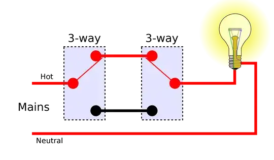

Your circuit contains two 3-way switches. Referring to the diagram below:
  • if the switch with the incoming "hot" is the one you want single control from (shown at left)-
1) replace that switch with a single-pole switch
2) connect either of the "traveler" wires to the load side
3) remove the other (unwanted) switch and connect the traveler wire used in step-2 to the "switched hot" wire that goes to the lights.
4) the unused "traveler" wire is abandoned
  • If the switch without the incoming "hot" is the one you want single control from (shown at right)-
1) remove the switch with the incoming hot (shown at left) and connect the incoming hot to either of the "traveler" wires
2) replace the other switch (shown at right) with a single-pole switch
3) connect the "traveler" wire used in step 1 to one side of the switch
4) connect the "switched hot" that goes to the lights to the other side of the switch.
5) the unused "traveler" wire is abandoned
