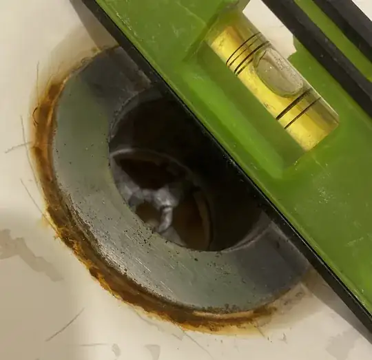

This is a problem and needs to be filled with a fiberglass resin. If not, Your tub will look like mine enter image description here
Tom
