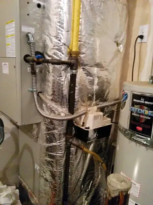

I want to install a house humidifier. Right now I'm thinking of buying an Aprilaire 600. But my house set up does not look anything like the videos I've seen. Are the vents behind the insulation? See picture. I'm thinking of putting it right above the drain pump. Would that work?

Yes, the ducts are behind that silver insulation. Cutting the Aprilaire 600 in above the condensation pump as you suggested would be ideal.

I just installed one of those. It needs a gravity drain and has a ton of overflow, so definitely you'll need to install above the pump. Be aware you need to tie into both the supply and the return ducts (one will be above the furnace and the other to the side). Also, I'd recommend against using that brand in an unconditioned space. It is not very tightly sealed and leaks a fair amount of air and the housing is not insulated. The controls and the sensor are the same device and needs to be mounted onto the wall of a duct upstream of the unit. I would recommend a steam injection unit rather than a bypass, however they are more expensive.
