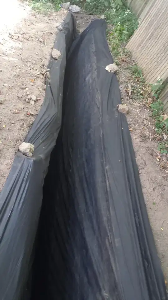

I need your help! I own a house near a state road (trucks, buses are allowed) near Philadelphia. With the bad snow years the past few years, our road condition deteriorated but not so badly (little bumps), but badly enough to shake/vibrate my home when big trucks/buses go by (about 45 miles per hour). I'm trying to find a way to perhaps dig the backyard about 6ft (1-2ft wide), and pour in concrete or something that can dampen the vibration (person from Lowe's said this). Is there anything I can do? FYI: distance to my home from the street is about 100 - 150ft (our backyard). I'm willing to spend the money as long as I can eliminate this vibration coming from the state road through the ground.
Things I have done already:
  1. I spoke to the local police station if they can lower the speed limit. They said "No."
  2. I put 2 tons of rocks against the fence (to the state road) to push down the ground to dampen the vibration coming from the traffic through the ground. It didn't do much (slight improvement).
Your advice will be appreciated! FYI: My home is shown here in blue dot next to the state road (Lancaster Ave).
I posted this to one person, but thought it can benefit more folks.
What I did (digging 6ft x 90ft inground trench, and pouring sand to fill it) didn't work. I ended up wasting $15K...My home still shakes, and I'm out of ideas... If it worked, I was going to put up some photos of all the work, but what a bummer (so if you are having a similar issue - don't dig!). I followed the research work by someone in Canada who I liked the idea of, but oh well. Asked the township to resurface the road and stuff. They'll do it over this summer, and I'm hoping that can do the trick. Below is the picture right before sand was poured in.

  • Thanks for your input @user37996. I called in the contractors for the in-ground barrier (6ft deep, 2.5ft wide - along my fence (~60ft)). I'm going to put in concrete to seal off any vibration from the road. Again, the vibration is not too bad where it is damaging the house - it's just gets on my nerves. I'm hoping the estimate isn't too expense... I'll report back here to share my experience with you all! I'm sure many houses along the road shares my concerns. – John Jun 03 '15 at 13:52
  • @John, how did it go? – Phil Esra Apr 28 '16 at 05:59
  • @PhilEsra, It didn't work. I ended up wasting $15K on digging 6ft x 90ft trench and poured sand to fill it. My home still shakes, and I'm out of ideas... If it worked, I was going to put up some photos of all the work, but what a bummer. I followed the research work by someone in Canada who I liked the idea of, but oh well. Asked the township to resurface the road and stuff. They'll do it over this summer, and I'm hoping that can do the trick. – John Jul 07 '16 at 18:07
