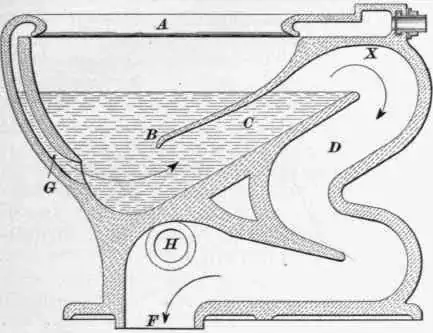

The hole in question is a siphon jet. It concentrates flow from the tank, jump-starting the siphoning effect.
If you look close (I’m not suggesting you do), there’s a siphon jet hole (see letter G on diagram) in the bottom of the toilet bowl. It’s hard to see unless you put your head in the toilet (For the record, I didn’t do this). When you flush, water shoots out of this hole to fill the drain pipe. This creates a siphon.
When I investigated, it was plugged. Eureka! I cleaned it out and once again heard that perfect flush. -tomlaforce.com
See (acid), How to clean under the narrow toilet rim to restore full flush power
When you flush the toilet in the diagram, the chamber directly above the X fills with water. This chamber is connected to the same passage where the air is, above G. It's also where all the holes are and once they fill with water, the air is forced out through G.
A noticed change may be a clog somewhere but perhaps as the guest toilet, you never realized how poorly it preformed out of the box. IME this is typical of low-flow toilets but also of every toilet that hasn't been flushed in a while.
You may be interested in adjusting or installing a chain float which will hopefully allow enough water to flow after the bubble pops, to create a siphon.

    If the OP is getting a big bubble coming out of the siphon jet, it isn't clogged, but a lot of air in the region above it ("A" in your diagram) is getting trapped and forced down the siphon jet. The "A" region has a number of small holes that lead into the bowl in order to rinse down the sides. If a lot of these holes are blocked, this would explain why air is getting trapped. Normally, the air can vent through these holes. Use something like a straightened wire shirt hanger to clear them out. – Dave Tweed Apr 12 '15 at 14:27
  • ... Although if this is a brand-new toilet, I'm not sure why there would be any clogging. Perhaps it's a manufacturing defect, and it should be replaced. – Dave Tweed Apr 12 '15 at 14:34
  • @DaveTweed I tried doing this, and on all the vent holes I was able to insert about 1.5" of coat hangar wire into the vent. There is one vent that I cannot insert a wire hangar into, so, one vent that is plugged for some reason. It appears to be rusty somehow (I know, it's not metal, it just looks rusty). No amount of force is getting that wire into the one vent directly in the front of the bowl. – Gorchestopher H Apr 13 '15 at 01:12
  • @GorchestopherH I'd try using a garden hose. You run the risk of cracking it by shoving metal inside. – Mazura Apr 13 '15 at 01:20
  • I don't think that one plugged vent hole is enough to explain the big bubble. There must be something fairly substantial wedged in the "A" space above that hole. At this point, I guess I'd try disconnecting the tank from the bowl and seeing whether I can run a flexible snake from there into the "A" space, around the rim of the bowl in both directions. This would depend on the specific design of your bowl. Can you take a picture of it? – Dave Tweed Apr 13 '15 at 01:50

  • FIXED!!! I had a problem where big bubbles where coming out of my siphon jet (G on the diagram) when I flushed my toilet. I did as suggested and cleaned out the holes (A on the diagram) and it fixed the problem immediately! – Wil Jan 22 '20 at 17:29
UNSTOPPING THE JET HOLE FIXED IT! (see letter G on diagram).
I have a $800 designer toilet that has never flushed. The week it was installed we had a major, long-term health issue, so the issue wasn’t addressed for over 3 years (thus the toilet was not immediately returned). Since then I have replaced/customized the fill/release valve three times; taken the entire toilet out, snaked the line, and carefully replaced the wax ring; and run a garden hose down the roof vent pipe. The clue was the big air bubbles in the bowl at the start of flushing. When I read this thread, I flushed, and no water at all came out the jet/siphon hole. I carefully probed it with a small screw diver and it was totally plugged, but hard small chunks of sand/cement/calcium(?) came loose. I then used a 14” plastic snake (used to remove drain hairballs) in the siphon hole and more granular junk came out – about 2tbs. Once I could get the snake all the way in, the commode was immediately able to FLUSH!!! I poured about ½ gallon of vinegar in the bowl to soak overnight and will use the plastic snake again tomorrow. My theory is this plug was from some kind of sand casting process during manufacturing.
