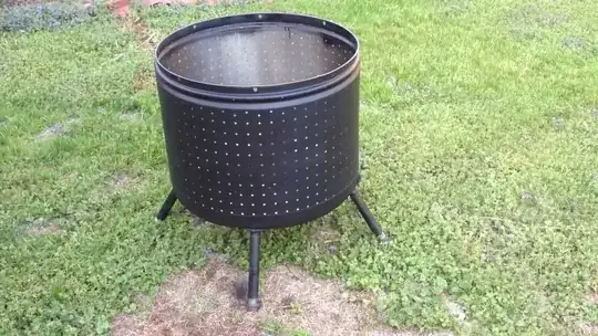

The internal bowl/barrel of an old washing machine works well for an above-ground solution - the holes around the sides allow the embers to breathe well and help to radiate heat.
Washing Machine Fire Pit
You can add legs as this person has, or simply prop it up on a slab or some bricks.
Just make sure that it IS metal - a lot of the newer/cheaper washing machines use plastic barrels, which... don't work.

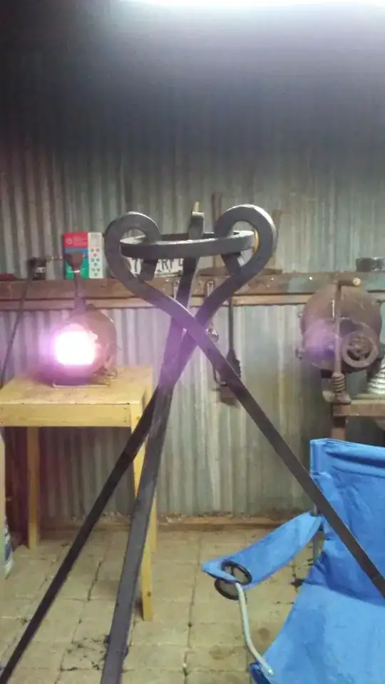

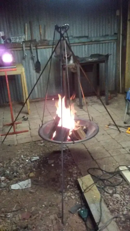

I came up with this in about an hour with stuff laying around my blacksmiths shop. Just happened to have a firebowl from a storebought pit. The tripod is made of 1/2" hot rolled square and the hangars are 1/4" sq. All in all probably 15 bucks worth of metal. Super easy to make and super portable as well, as it can be taken apart and hangs flat on a hook on a wall.
