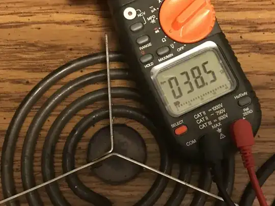

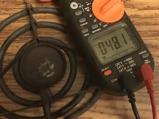

Yes, the different coil numbers will have a different resistance (see pictures). But, naturally they would, since they are rated for different wattages (remember, W = I^2 * R, that is, Watts is the current squared, times the resistance. The voltage is the same (240 Volts) and more current will flow through the LOWER resistance, so the lower resistance coil is the higher power one).
However, the controller appears to be quite capable of handling the difference (at least the ones on my Tappan range cooktop). And, judging from all the many dozens of numbers of infinite switches on the parts supplier crossover list, they don't appear to be 'finely tuned' to the burner size or coil number.
I replaced an 8", 4-coil, with an 8", 5-coil. And, I replaced a 6", 3-coil, with a 6", 4-coil. They both work well. They both seem to heat faster and more evenly, and will bring pots to boil quicker on high. They are also 'flatter' on the bottoms of pots and pans.
