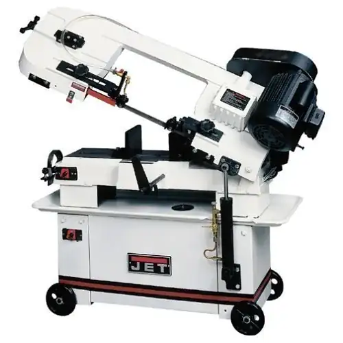

I am not an iron worker, but from what I understand the best tool for a fixed location job, meaning you have all the beams right in front of you and you can position them however you want, is a horizontal band saw like this:
horizontal band saw
There are band saw blades that are exactly designed for cutting structural steel and they work perfectly for that application.

  • Nice thing except it requires a large table for dealing with long beams. – sharptooth Jun 02 '15 at 13:28
  • @sharptooth The beam has to be set up on a horse. The OP should be doing that no matter what method he uses. – Tyler Durden Jun 02 '15 at 13:30
  • Okay, but how would you combine this machine with a horse such that they are both on the right height? – sharptooth Jun 02 '15 at 13:32
  • @sharptooth If it was me, I would probably use two double stacks of cinder block. Each cinder block is 8 inches high, so five-high is 40 inches which is the height of the table of a band saw. You can alternate the cinder blocks when you stack them, so they are interlocked. It makes a very sturdy platform. You need two such supports obviously when cutting a long beam. – Tyler Durden Jun 02 '15 at 13:43
