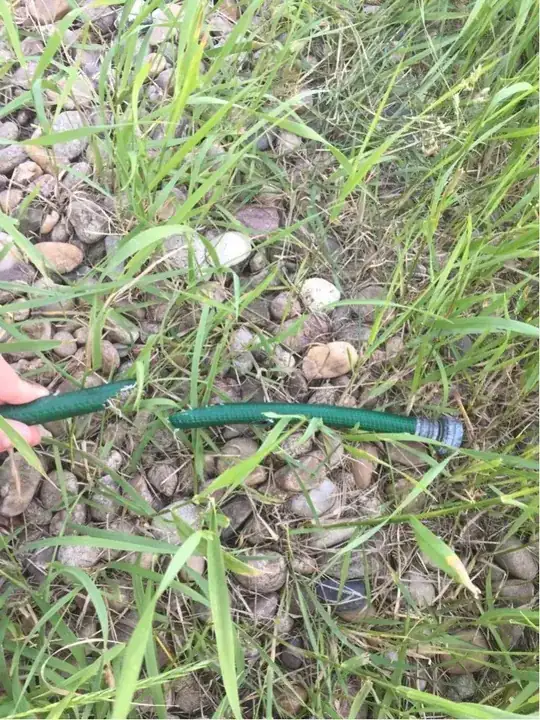

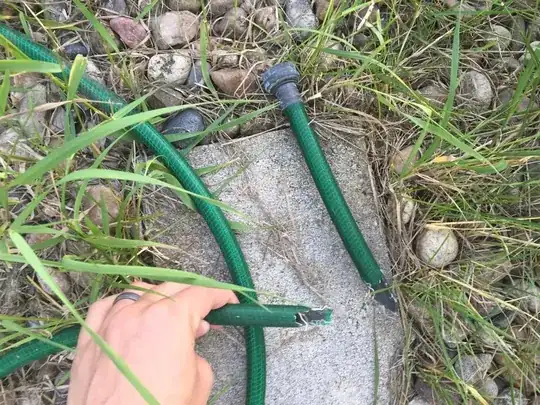

My wife and I recently bought a house, and we discovered there were buried hoses near all of our hose nozzles. We turned them on and to our surprise they were tied to sprinkler heads throughout the yard.
Anyway, one hose was broken (as shown in the pictures below) and because of how the hoses are used and they're buried, it'd be nice to be able to fix it without having to dig the entire hose up. How can we fix a hose like this?

    Cut end cleanly, install new end fitting. Or install splice fitting. Both should be available from any hardware store. Before going shopping, measure the inside diameter of the hose so you get the right size. – keshlam Jun 07 '15 at 16:47
There are garden hose splice devices that you can purchase at home centers and big box stores that can be used to fix these. You may lose a short bit of total length as you cut off the damaged part to accomodate the splicer.
If you need more added length you could use two of these splicers to stitch in a new length of hose.
They also sell devices that will attach new hose ends as well.
In your situation the hose ends that are broken may be broken from having laid out in the sun for years at a time. The sun treatment can make the hose hard and brittle. On the other hand the part of the hose in the soil may still be in decent shape. You could cut off the old hose all the way back to where it is in the soil and splice on a piece cut from a new hose that already has the faucet tap fitting on the end.
