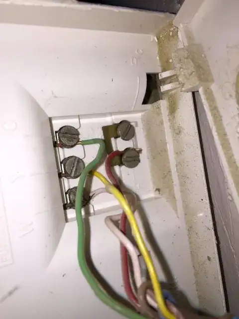

I have a very old Honeywell programmable thermostat. I am going to replace it with a White-Rodgers UP500W Emerson Sensi WiFi Thermostat.
I just want to know if the WiFi unit will work without a C wire. This is what they said:
In certain situations, Sensi does require a common or "C" wire. On "heat only" or "cool only" systems, Sensi requires a "C" wire to power the Wi-Fi radio. Without a "C" wire installed, the Wi-Fi connection will drop off after about two hours to preserve the AA batteries. On combined heating and cooling systems, Sensi does not require a "C" wire because the thermostat is designed to "Power Share" between the two systems. For example, on a call for heat, Sensi will use a small amount of power from the cooling system to power the Wi-Fi radio. In "Power Sharing" mode, the AA batteries may last more than a year.
Since the one I have is for both heating and cooling, I think I should be fine. I just need someone to confirm that.

    Why not just install a `C` wire? It looks like you have an extra blue wire in the cable, why not just hook it up? – Tester101 Jun 17 '15 at 01:07
  • If [this answer](http://diy.stackexchange.com/a/10527/33) isn't enough to help you install a `C` wire, just ask a new question being sure to include the make and model number of the heating and cooling equipment you're using. – Tester101 Jun 17 '15 at 01:10
  • @Tester101 , I opened it up again, I do have 2 extra wires, one is blue, and one is brown. does it matter which one I use? – qinking126 Jun 17 '15 at 01:22
    It's more common to use the blue wire, but it really doesn't matter which one you use. You will have to connect whichever wire you choose to both the thermostat, and the HVAC system. – Tester101 Jun 17 '15 at 02:26
