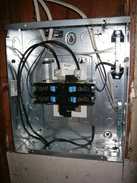

The neutral bus will be the one(s) mounted on a plastic standoff, like the hot buses are. The neutral (grounded) bus bar is the one on your right in the first picture below, mounted on the black plastic standoffs. If there is a screw that goes through the neutral bus and into the panel itself (a metal connection from the neutral bar to the panel), it should be removed in a sub panel. The grounding bus bar is the one on your left, bonded directly to the panel housing.
In the second picture, the neutral bus is the one in the top right corner of the panel. And incidentally, the panel in the second picture is wired up incorrectly. It's obviously a sub panel, but you can see that it is only fed by three wires, and the neutral and grounding buses are electrically bonded together with a couple of white wires. To be corrected, that panel in the pictures needs a 4th wire--a ground wire going all the way back to the main panel, and the neutral and grounding buses must be disconnected.
A subpanel Another subpanel
