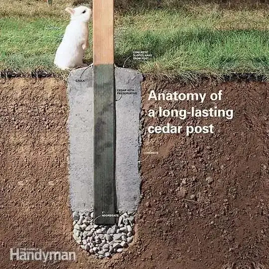

12
With regard to using wood posts in concrete:
Image Source
Note that any water that drains down the side of the wood post will drain through to the subsoil. The post should be in a collar, not a cup...
(Feel free to integrate into the answer of @sch )
DJohnM
  • 1,020
    Is everything in the picture necessary? If so, where can I buy cheap bunnies? – PlasmaHH Jun 19 '15 at 08:32
  • 37
    @PlasmaHH The bunny is necessary to provide extra bracing on the downwind side of the post. If you live in an area with higher winds, it's recommended to use a badger or even a small deer. – David Richerby Jun 19 '15 at 10:16
  • I can't read the small black text and can't make the picture bigger. There's also no source link so: What's the black thing around the wood in the cement? – Zach Mierzejewski Jun 19 '15 at 17:09
    It came from here: http://www.familyhandyman.com/garden-structures/fences/how-to-set-fence-posts-that-won-t-rot/view-all – DJohnM Jun 19 '15 at 19:31
    @ZachMierzejewski from the source image (which I've submitted a suggested edit for) it's "cedar with preservative." – Matt Ball Jun 19 '15 at 23:45
    This is correct assuming the earth drains well. I high-clay areas, you likely want to avoid below-grown timber all together. – DA01 Jun 20 '15 at 15:41
  • Bunny is *Local Inspector* – Wayfaring Stranger Jun 21 '15 at 13:24
