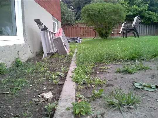

And here is a soil level picture

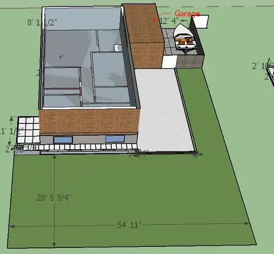

  • My plan is to redistribute the soil. Next to the small three that you see in the picture is the corner of my patio that was fixed (raised). Now that corner is 23/8" higher that the line of concrete blocks that you see in the picture. I am planning to build a walkway where the two ladders are. That would be the reference level. From that quote I need to grade the soil toward the right side (bottom side of the above diagram) My question is more related to what problems could I have if I used b) and a rototiller. Are there any other options? – MiniMe Jun 30 '15 at 23:55

I have not had a good experience with tilling an existing lawn. The existing grass does not get shredded completely but will form lumps that make for an uneven surface. Depending on how much top soil you have, you may bring out a lot of sand and rocks. Even a small electric tiller can go as deep as 6-8 inches. If your top soil is not at least 12 inches, it will be a long and labor-intensive process to get back your lawn without spreading additional screened loam.
What a landscaper will do with a bobcat (as I have just observed in my neighbor's yard) is
  • scrape off the sod and discard
  • try to salvage as much loam as possible and dump it on a pile that is out of the way
  • grade the land as desired
  • re-spread the loam, and add new loam if needed
  • reseed
