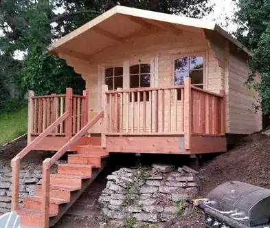

I'm in the process of building an outdoor office in my back yard (mainly as a "man cave" and quiet place to work from home).
The picture makes it look large but it's actually just a 10 x 12 shed.
Core construction is complete and now I'd like to run electrical out to it (two circuits so I can have an air conditioner or heater if needed). I've had several electricians come out to provide bids but there seems to be a difference of opinion on how to proceed.
