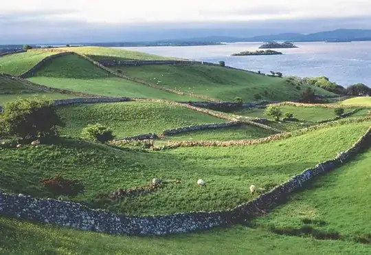

Honestly, I would imagine your walls will be just fine with a little water running over them. The stone walls all over the Irish countryside have been standing for a year or two and seem to cope with the wet, cold North Sea coastal weather pretty well, and most of those aren't even set in mortar. ;-)
What I definitely would do is consider what kind of footing the wall is built on. If there's a chance of water running down the wall and digging a trough at the base that undermines the wall, you might beef up the footing and/or build in some drainage.

  • Thanks, but do note that the walls shown aren't retaining walls, and so don't need to hold back any force. – Daniel Griscom Jul 14 '15 at 11:20
  • @DanielGriscom Sure, but if water does dig a channel under the wall it could still fall down. – Craig Tullis Jul 14 '15 at 15:44
  • Sorry, wasn't clear: the walls shown in the Iris countryside aren't retaining walls, and perhaps don't need to be as strong as those holding up my driveway, and so perhaps don't need to fear water pouring over them as mine. – Daniel Griscom Jul 14 '15 at 19:19
  • @DanielGriscom, oh, I see. By "the walls shown" you didn't mean the ones *you* showed. ;-) So...I still wouldn't worry *too* much about water on the walls themselves, but I would look seriously at the foundation of the walls and make sure you have good drainage so water isn't pooling. These aren't exactly holding up your whole drive, in the same way that a dam isn't actually holding back all the cumulative pressure of all the water in a reservoir, but rather holding back just the pressure of the water column in contact with the dam. – Craig Tullis Jul 14 '15 at 19:33
