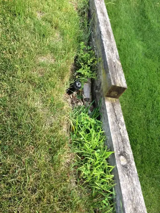

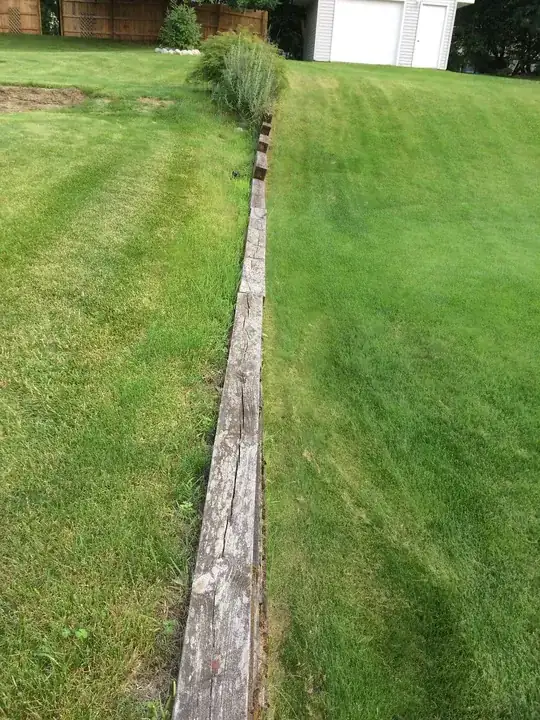

My timber retaining wall is falling over, I'm just wondering what my options are? Is there a way to fix what I've got, or will I need to dig this whole area out and rebuild? You can't tell from the pictures but it's about 3-4 feet tall.
Photo: enter image description here enter image description here

    Not sure how/where that sprinkler head sprays, but it could be contributing to the erosion. This makes me suspect that there's not good drainage behind the wall, which likely is at least part of the reason the wall is tipping. When you rebuild the wall, make sure you include good drainage. – Tester101 Jul 13 '15 at 20:58
    Please include a side shot. You're right...it's really impossible to judge the height here. – DA01 Jul 14 '15 at 00:51
    I'm having a hard time figuring out why there is a retaining wall there in the first place. The pictures might be at a bad angle, but it looks like you can just remove the wall entirely and grade out the area by adding a lot of soil on the low side and smoothing it out. That would be a much cheaper option that replacing the wall. – Jason Hutchinson Jul 14 '15 at 18:51

It's quite hard to tell how big this wall is but you stated it's 3-4' tall.
It looks like it was built simply as a vertical wall. There's nothing you can do about it. It was inevitably going to tip over. So yes, you do have to dig it out.

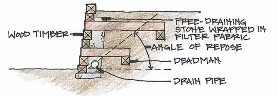

If you want to replace it with timber, you need to add something called deadmen to it. A deadman is a timber that runs perpendicular to the wall itself that is then attached to another timber that runs parallel to the wall itself. Diagram:
Without those, your timber wall will always end up getting pushed over eventually.
The catch is, of course, to bury the deadman, you need to excavate all the dirt behind the wall back to about the same depth as the wall...so you'd be moving the 4' of dirt behind the wall as well. That may or may not work depending on who's side of the yard that is.
