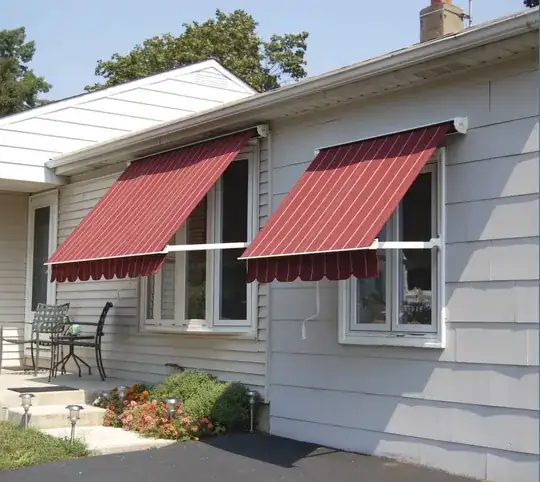

But you can get fancier as well with things such as shutters:

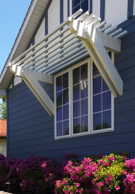

Possibly more expensive (more complicated to install) would be an awning:
Or a window trellis/arbor/pergola:
