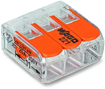

There are also lever-action clamping connectors that allow solid, stranded and fine-stranded wires to be connected:
For example Wago 221 series
Other connector manufacturers exist.
