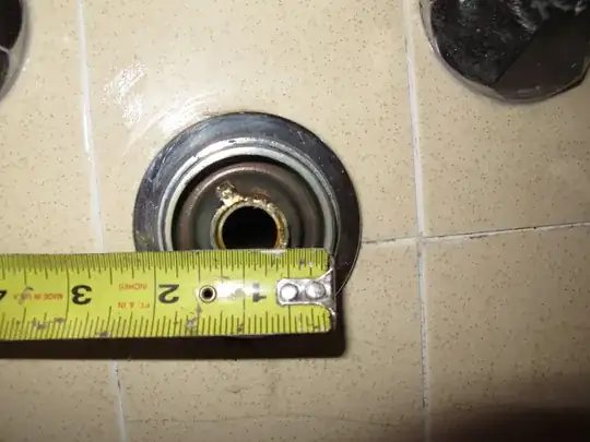

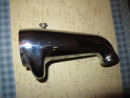

enter image description hereenter image description hereWe have a 1940 Crane bathtub spout that leaks when the shower-head is on. We want to replace the spout, so we have removed it but need to remove the base adapter (correct term?) that is inside the wall. We have been unable to find the right tool that is compatible with the fitter on the old adapter. Does anyone know where we can find one?

  • Have any pictures? – Edwin Jul 22 '15 at 02:41
  • We will take pictures. In the meantime we have considered using a pipe wrench to remove the adapter ~ which will destroy the threads, but we will need to replace the pipe anyway. We only need to remove the adapter because we need to replace the 1940 spout, and the adapter is not compatible with current spouts on the market. We would prefer to find a Crane 1940 replacement spout but have been unsuccessful. – RET Jul 22 '15 at 14:54
  • I have attached two photos of the spout and adapter. – RET Jul 24 '15 at 03:09
  • I've never seen anything like it. Are you sure the escutcheon is part of the adapter? It looks like it might pop off from the picture. If not, it seems like the adapter tightens to the wall from the inside. Do you have access to the back? – Edwin Jul 24 '15 at 05:16
  • We removed the spout ourselves and it was attached to the adapter. A major plumbing store in our town said the same thing ~ they've never seen anything like it either. We have since called a Plumber to assist us. Unfortunately we will probably need to remove some tile on the tub side to fix this problem, then put a chrome plate over that area ~ tile is very old and can't be matched. There is tile on the other side of the wall in another bathroom so we can't access from there. – RET Jul 31 '15 at 03:59
    Too bad you can't save it. As for the tile; you might be surprised. It looks like it might be a common tile from the era. People who do a lot of demo probably come across it on a regular basis. If you are willing to spend time/money I almost guarantee you can find it. I might have even pulled some of that tile from my home a couple of years ago! Probably not worth the effort though, since you can't keep the fixture. – Edwin Aug 04 '15 at 03:41
