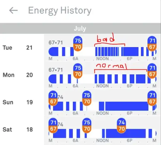

Here's a photo that shows the daytime shutoffs yesterday (Tuesday) between noon and 6pm as compared to the days prior. Notice that in the night and early morning it operates normally.
Tuesday weirdness
So what's happening? Is it overheating?

  • @Tester101 not cool for sure, but rapidly. Starts blowing warm at minute 2-3, but at minute 5 the heat pump kicks back in and it rapidly goes cold again. When this is happening it never even comes close to the set point. 105F outside, trying to hit 75F, cuts out around 79-85F trying to cool. In early morning and evening it operates normally and hits set point no problem. – Haney Jul 23 '15 at 01:56

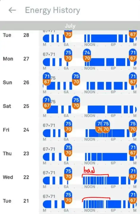

Actual, better answer:
The heat pump was definitely overheating. Since the heat wave has passed, there have been 0 issues. The ambient outside temperature is 90-95 °F this week, whereas it was 103 - 105 °F last week. This seems to make all the difference as things are purring along and the home is staying cool. Thanks for the help everyone!
Heat Pump Working Properly
