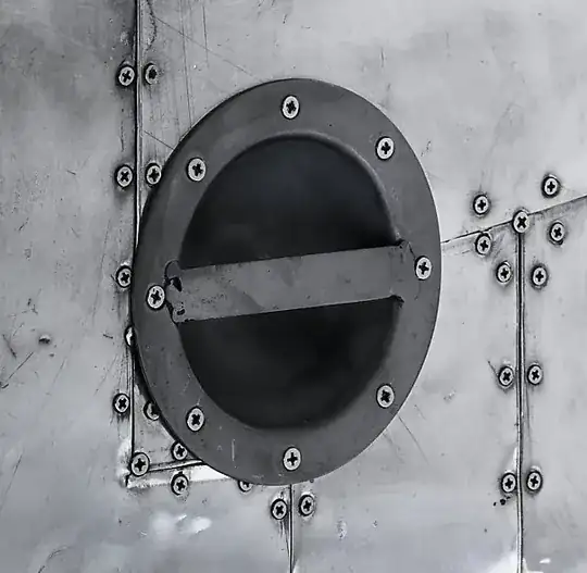

I am currently doing the same thing; while sealing it for a radon system. The radon pipe will be through the slab in a separate spot in the basement. I am using a piece of clear Lexan with rubber foam rope insulation underneath it.
Here is my finished cover. It works fantastically. Access hole with removable seal. Uniseals for the cords and pipe.

  • Nice setup, but OP doesn't have a clean, flat mounting surface like you did. Suggestions? – isherwood Dec 04 '15 at 15:34
    Not sure on unlevel mounting surface; maybe larger weather stripping? The suction the radon fan creates is amazing. When I pull the cord seal, wow; the air that gets pulled in is crazy. I have a suburb home with nice gravel under my slab. I would estimate my system would have been quoted at $1500-2000. I did it for $450. The sump pump is in a far corner sealed off. The radon pipe enters the slab elsewhere, runs into my garage through the rim joist, up a garage corner in to my garage attic (where the fan is located) and out a gable vent. – Evil Elf Dec 04 '15 at 19:28
    As far as help, Val was a TREMENDOUS help. His site is http://www.indoor-air-health-advisor.com/diy-radon-mitigation.html and his prices were lower than anywhere else. I got the radon supplies and my sump pump cover supplies from his store. I am not associated with him in any way. I bombarded him with questions via email and he was very kind to guide me along the way. – Evil Elf Dec 04 '15 at 19:31
  • Can you share more details on the rubber foam rope installation and it also looks like you have screws as well. How did you put those in and with what? Thanks – Mike Jul 27 '17 at 02:44
  • I just drilled holes and used plastic anchors with screws. – Evil Elf Jul 27 '17 at 19:45
  • I think leveling could be done with vinyl concrete repair patch. I used the foam rubber seal with self adhesive and screwed right through it after drilling pilot holes. – Evil Elf Jul 27 '17 at 19:47
