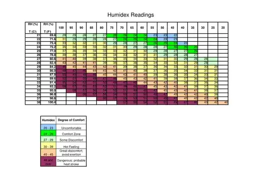

I found this graph: Temperature Settings
The image is a link to a PDF.
