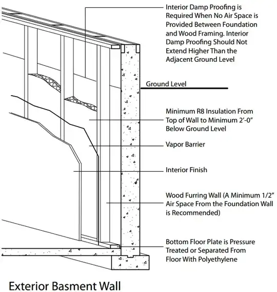

I should mention more detail. The area is fairly dry, but ranges quite a bit in temperatures (Plant zone 3). Grading does not cause a lot of water to pool. The issue is more with condensation. The city code requires "damp proofing" and I'm trying to see what options there are.

  • I've removed the old setup, which was 2x2 framing along concrete with fiberboard on top of it. (and a coat of paint). This lets through a lot of heat and moisture. After discovering this I've gutted the basement in two rooms, and I'm preparing to insulate, which should reduce the moisture. I'm just not sure if I should leave the 1" space between the wall and the walls or look to a product that I can put in between, like a dimpled membrane, some sort of reflective foil, polystyrene, or a chemical sealant. – Daniel Aug 18 '15 at 18:03
  • @Daniel read my answer here: http://diy.stackexchange.com/a/8644/1209 that explains the current best practice for finished basement walls based on Building Science corporations research. In summary, a sealant will do nothing to prevent condensation, and a gap only allows a space for more airflow. You want to reduce that gap (spray foam is ideal, foam board OK). – DA01 Aug 18 '15 at 18:16
