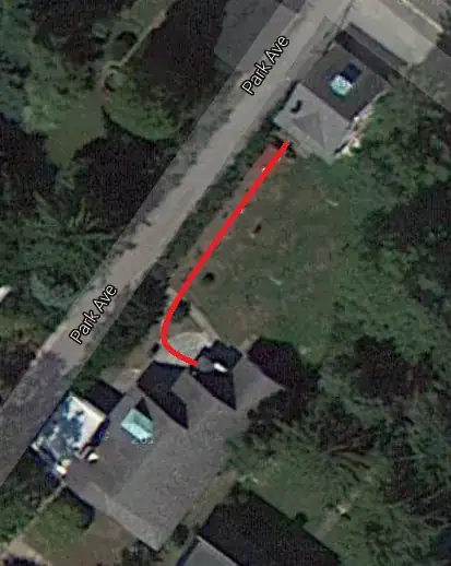

I'm trying to run ethernet cable about 250ft underground to the garage. It is going through a hard plastic/rubber tubing under the yard and into the garage. Is there anything I should know before doing this? UTP/STP? cat 5e/cat 6? If a location of where to buy decent cable is allowed, I would be interested in that as well.
House to Garage line

  • I learned that its a plastic/hard rubber tubing under the ground from my house to the garage. So, if I run the ethernet from my router, underground to the garage, then had the ethernet surge protector in between both ends...would that be okay? What else would i have to worry about? (serious question) – Aaron Aug 23 '15 at 14:35
    @Aaron offhand, I'd say you're probably okay. You're definitely better off than if you were stringing the cable up in some trees, right? :-) Do you know how deep the tubing is? Ideally it's at least 18" deep. Is there anything else already in that tubing? Specifically, you're not supposed to run line voltage and low voltage in the same conduit. Not to mention the fact if that tubing isn't actually so-called liquidtite flexible PVC conduit, or the gray schedule 80 (schedule 40 might be okay in some places if local code makes exceptions) PVC, there shouldn't be any line voltage wires in it. – Craig Tullis Aug 23 '15 at 15:41
  • It's like a garden hose type tube. It's a very hard ruber/plastic that doesn't bend at all (I tried). And it is 4 feet deep. We already have string through it that we can attach a cable to and pull it to the other side. There's no bends at all, just curve. Picture of how it goes http://i.imgur.com/pxvNihR.png - So you think we are good then as long as we ground both ends? – Aaron Aug 23 '15 at 16:06
    @Aaron 4 feet sounds good. I'd do it, if it was my place. I really like the point-to-point wireless equipment from a certain vendor and if cable was infeasible or the place was bigger, I'd seriously consider wireless. But wireless just can't beat wire or fiber. I definitely would also heed the advice about using cable rated for wet locations, and double-check the quality of the grounding. Ground both the surge arrestors and the switches. – Craig Tullis Aug 23 '15 at 16:12
  • What do you mean by surge arresters? Just to ground the ethernet via the APC product you linked, and then make sure the router/switch on the other end is plugged into a grounded outlet and also going into a surge protector-typeish device? – Aaron Aug 23 '15 at 16:20
