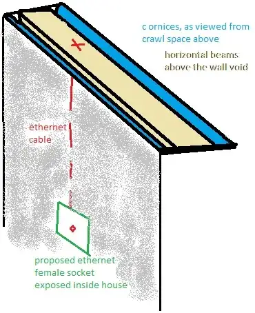

I want to install an ethernet jack in an interior wall of one room. I'd like to run the cable up through the wall cavity (so it is hidden) into the crawl space and back down another wall to another jack which would be connected to the network router. I presume this is a pretty basic thing to do but I'm not sure how to access the wall cavity. The walls are covered by a horizontal beam that gives me no clue what is underneath or how high they are.
Should I drill down at the red X(see picture) and feed the cable through, then guess the right spot to drill a hole at the site of proposed jack (coloured green)?
Diagram of problem

As others have mentioned, there may or may not be stuff in the wall obstructing your plan. But most likely not (insulation it the most likely, but should not stop you). Find an area between the studs and cut a hole in the wall where your box will go as other have described. Then drill a 3/4" - 1" hole in top plate within the same stud cavity. That's the easy part.
To actually fish the wire (up or down), you really should get steel fish tape. I spent so many years fishing wire without this, and once I discovered them, I realized I could have saved so much time. It is a steel wire that rolls up but does not bend left to right, so you can put it up or down the cavity (down would probably be easier as you can stick your hand in the hole too grab it). One you have it pulled through, attach your wire to the end, and pull it back up. Believe, this will well worth the $7.99 you will spend.

  • Thanks for advice so far. I take from this that the pale brown thing in my picture is called the top plate. My concern is about where I drill down through that and how thick I should expect the top plate to be. Or perhaps this is trivial. – Lisa Jun 30 '11 at 04:41
  • Yes, that is the top plate. B Mitch's answer describes the thickness, either 1.5" or 3" is most likely. As for where to drill, use a stud finder to locate the 2 studs on either side of the proposed location. Drilling your hole anywhere in between will be fine. – mohlsen Jun 30 '11 at 12:14

To help you with the terms, what you're looking at from above is the top plate. Frequently there are two 2x4's for a top plate. Two boards are used for added structure at the joints and extra fire proofing. This gives you about 3" of wood to drill through.
As ChrisF mentions, you should run a stud finder up and down the wall cavity near the halfway point to see if any fire blocking has been installed. This would be a single 2x4, and will almost always be in a wall if the ceilings are over 8' tall.
You'll significantly reduce the odds of insulation in the wall if you are doing this project on interior walls. You should also be avoiding any electrical in the same wall cavity (between the same two studs). You would see an outlet, switch, or wire coming out of the top plate if this were the case.
As for the actual wiring, I've used these low voltage mounting brackets for the hole in the wall. Place the bracket on the wall where you want the opening, mark the corners and sides, and cut out the drywall with a drywall saw. Test fit the bracket and file back any spots that are blocking you until you get a snug fit. Then bend the tabs back into the wall and tighten them with a pair of pliers. On that bracket, I use a modular plate (these comes with more openings if you need them) and then an ethernet jack mounted in the plate. You can also get jacks for cable, phone, stereo, etc.

    I agree in general. I would recommend the use of an old-work J-box instead of a plate mounting bracket, especially if it turns out the wall is insulated. Yes, it's low-voltage, but the J-box helps protect the delicate back-wiring for connections like Cat-5, much like it does for high-voltage lines. – KeithS Jun 28 '11 at 14:33
    If it's insulated, fishing the wires down the wall will be a pain. Better off installing in another wall if possible. With the exception of walls bordering the outside or noisy areas (bathroom drain pipes) most walls inside the home are not insulated. – BMitch Jun 28 '11 at 15:53

  • Thank you. This and ChrisF cover my needs. Marking this as the answer because it provides the level of detail I clearly need. (Thanks for understanding I did not know it was called a top plate). – Lisa Jun 30 '11 at 04:51
  • Secondly, I doubt the wall contains insulation, but will know as soon as I create the hole in the wall for the 'wall plate'. – Lisa Jun 30 '11 at 04:52

Theoretically this should work, however there could be other cross pieces in the framework that would block your path to the location of the socket.
You would need to get a drill bit that could reach all the way down.
There could also be insulation in the cavity that would block your path too.

  • Thanks. How long do you think the drill bit would likely need to be? I have a 9mm timber drill bit which could go through 100mm or more. The house is in Australia and was built in 2004 so all modern. – Lisa Jun 30 '11 at 04:45
  • @Lisa - 9mm might be OK. Drill a hole in a test piece of wood to see if you can feed the cable through that easily. – ChrisF Jun 30 '11 at 07:46
