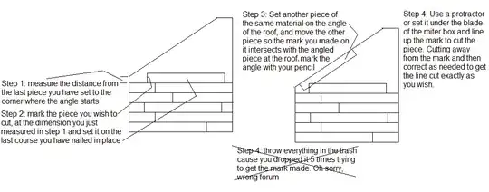

I am adding wood paneling to the wall, as you can see above. Starting with the next panel in the coming row I will need to cut the left end to fit the angle of the ceiling. How to I determine the angle I need to set my miter saw to?

Here is how I have done it before without anything more than what I was already using, the material, pencil, a tape measure and a miter box.

3+1 Love step 4 (first version.) Seems closely related to "I cut it off twice and it's still too short." – Ecnerwal Sep 08 '15 at 12:34
