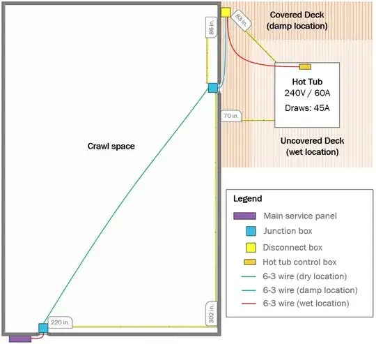

Plan
  1. Add a double pole 60A circuit breaker to my service panel. Service panel is on an outside wall of the house roughly 5ft from the ground.
  2. Run 6-3 wire (Q1*) from panel to junction box in crawl space. The wire will punch through a vent leading into the crawl space.
  3. Splice 6-3 wire (Q2*) together at junction box and run to junction box nearest tub.
  4. Splice 6-3 wire (Q3*) together at junction box and run through another vent exiting the crawl space to get to disconnect box. Disconnect box will contain GFCI (Q4*). Box is also mounted above the deck for easy access and on an outside wall which is covered.
  5. Run 6-3 wire (Q5*) from disconnect box to hot tub control box where it gets hard-wired.
    * Q1-Q5 refer to questions I have below.
Diagram

  • You ran 6/3 with ground, right? – Tester101 Sep 19 '15 at 23:28
  • Not sure what the cost difference is, but it might simplify the problem if you ran 6 AWG THWN conductors through PVC conduit the whole way. – Tester101 Sep 19 '15 at 23:40
  • Yes, I will need to run ground. Thanks for the THWN suggestion. I hadn't seen this option before and it should be cheaper than UF. If I use THWN, it looks like I wouldn't need the junction boxes either. Love it. – Scott Lin Sep 20 '15 at 03:14
