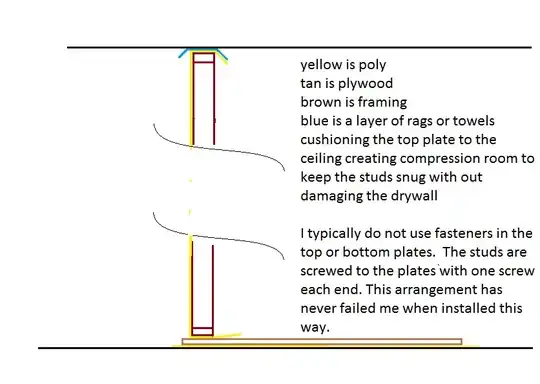

I build my dust wall with 4 mil poly and 2X4s. In areas of finished floors I use poly on the floor for spills and 1/4" plywood seamed with duct tape for durability, from dropping framing material and such. If I am using plywood protection, I build the 2X wall on the edge of the plywood. To save a lot of explanation, here is a sketch. dust wall

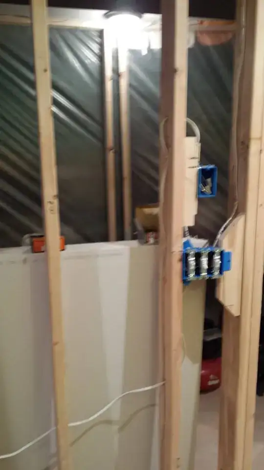

I have added a few pics of my last job where I built this type of dust wall, the pics were to highlight details behind the drywall after it was covered, not to highlight the dust wall, although the details show a little of the idea I am trying to get across. Davis wall1
