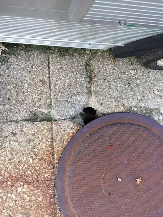

There is a sidewalk running over an old tunnel. It's near a grade school, and is used often by faculty and students. The tunnel is completely open, but blocked at both ends so there is no access under the sidewalk. A 6-inch hole has developed in the sidewalk and is now a trip hazard. Any idea how I could patch this hole, so it will hold until next summer when I can collapse the tunnel? The hole is next to a welded-shut manhole and is open into the tunnel, with a piece of steel (almost rusted through) spanning the hole.

    Rather than patch, would it make sense to just cover the entire area with a single sheetgood of some variety? Even a piece of tread plate (painted yellow to avoid more tripping) might do the trick. Cover, rather than patch since you intend to demolish it anyways? – BrownRedHawk Sep 25 '15 at 14:34
  • @BrownRedHawk Sounds like an answer (and safer than any patch). – bib Sep 25 '15 at 14:44
  • I see cracks extending from the whole are you sure this thing is structurally sound enough for people to be walking on right now I can't see the whole entire area so I can't say for sure but it might even be a good idea to keep traffic off of it – user41750 Sep 25 '15 at 23:14

If it's your tunnel (I presume if you plan to collapse it next year), I'd be just as concerned about the vehicles parked on top of it breaking through (given the obviously deteriorated condition of the sidewalk, and something parked right on top of it in your picture) as of people tripping, liability-wise.
  • Thanks for this idea.. I couldn't think of a way to create a bottom for the patch, but I think this could work. The vehicle in the photo is a little golf cart parked on the grass. We have considered the possibility of collapse, so the sidewalk will be eliminated altogether. Also, thanks for the tip on pumping grout into the tunnel. I've got a large amount of material to use as fill, so it's just a matter of bringing in a machine to do the digging, so it might be more cost effective than the grout option. But thanks! Something to consider. – MadTownSarah Sep 25 '15 at 16:27
