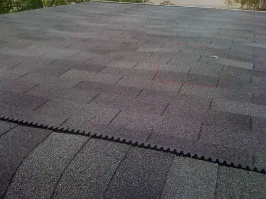

I just had a roof repaired (shingles replaced) because of hail damage. As far as I can tell, everything looks good. Except for one section, there's what I would only describe as a large bubble.
Are bubbles normal on new shingles, in such a way they'll work themselves out? Here's a picture, though it might not be apparent.
roof bubble
There are other soft spots in the roof, but this is by far the largest.

    Is it really bubbling up, or is the rest of the roof sinking down from roting plywood? Get a look from inside the attic and see if any of the plywood is turning black. – BMitch Jul 09 '11 at 02:23
  • @DTest, bubbles in a new (properly done) shingled roof isn't normal. Shingles should lay nice & flat on the roof. I think @BMitch could well be onto the real problem (above comment), did the weather get underneath your old shingles and soak the roof sheathing (normally OSB or Plywood)? – Mike Perry Jul 09 '11 at 04:18
  • Bubbles after more than a day or two of sunny weather are not normal. There is a problem under there unfortunately. – shirlock homes Jul 09 '11 at 09:29
  • Plywood doesn't have to rot to do this, only warp. Moisture or age. Newer construction often is done with clips between the sheeting to prevent or reduce this. – Fiasco Labs Jul 08 '13 at 15:21

Bubbles in a roof like this are NOT normal. They indicate a problem underneath. Is it serious? Possibly. It will probably decrease the life of the roof.
The shingles will have been nailed down, so this is not a case of the shingles simply pulling loose. Especially if the roof is soft there, it seems this must be a case of the plywood underneath having gotten wet and as it dried out, then warping and bubbling up underneath. The plywood should have been replaced where there were problems.

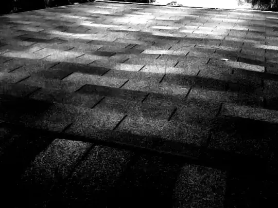

This problem likely has little to do with the shingles and lots to do with sagging within the plywood decking (AKA sheathing.) I modified your picture a bit -- noise was reduced to get rid of the color/light variations coming from the shingle aggregate, and an adjustment was made to increase contrast.
As you can see, you have lines going up and down your roof. These are your rafters underneath, and the low points are caused by the sag in the sheathing. This causes your roof to be "wavey" and although it isn't desirable, it is not altogether rare. It does appear that that one area is slightly worse than the rest, but nonetheless, the problem isn't limited to that one specific area.
