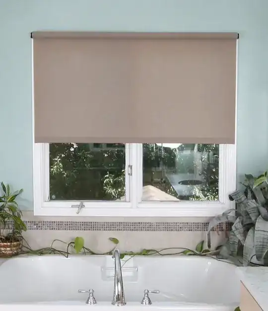

That film might be enough to fix the problem, and if you install it carefully, management will probably not care if you leave it in place when you move. If that alone doesn't block enough heat, you can also get "blackout" shades made of heavy, light blocking fabric. If you don't want curtains, a light blocking roll-up shade is another option, and basic models can be very inexpensive:
Roller shade

  • Hi JPhi1618, regarding 'you can also get "blackout" shades made of heavy, light blocking fabric,' do you mean on the outside of the window? Your photo shows one on the interior side but, unless the material is designed to reflect (preferably in invisible and visible wavelengths), wouldn't that _increase_ the heat transfer into the room? – Colin Q Bang Oct 09 '15 at 02:05
  • The fabric is typically white on the window side so it does help quite a bit. I was in the same situation in an apartment once and the blackout shade helped a lot. – JPhi1618 Oct 09 '15 at 02:19
