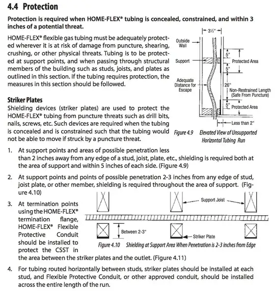

HomeFlex requires that horizontal runs through studs have 5" of protection on either side of each stud through which it passes (when it is within 2" of the edge, inevitable when dealing with 2x4s). However, HomeFlex does not provide a branded product to accomplish this (which is generally preferred, as mixing/matching brands in the same CSST install is usually a show-stopper for inspections), and I am unable to find anything of sufficient dimensions @ 16 gauge hardened steel that meet the requirements for protecting CSST.

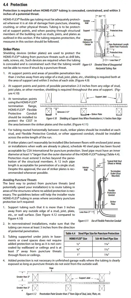

At this point, the only 2 options I can see to meet the requirements established by HomeFlex, are to either fabricate my own striker plates or to find the odd-sized 1-1/4" steel pipe that is noted as an acceptable alternative, and cut it to 11-1/2" lengths (5" + 1-1/2" + 5"). Are these really my only options (other than ripping it out and using black pipe)? What are others doing to address this requirement?
Here's the relevant part of the documentation (full doc is here):
Relevant manufacturer requirements

  • Can you post a link to the documentation, or quote the exact text here? – Tester101 Oct 12 '15 at 19:08
  • Apologies, I've added a screenshot of the relevant part of the documentation. I'll go ahead and add a link to the full document as well. – Wilco Oct 12 '15 at 19:17

The manufacturer's installation manual describes the plate that can be used, and even includes the part number.
Which is available at Home Depot, and Amazon.
It also says in the Protection section of the document "For tubing routed horizontally between studs, striker plates should be installed at each stud, and Flexible Protective Conduit, or other approved conduit, should be installed across the entire length of the run." (see point 4 below), and "schedule 40 steel pipe has been found acceptable by CSA International for puncture protection.". So you could always use schedule 40 steel pipe to protect the pipe. Just cut the pipe in 12" sections, and install the tubing in the pipe where it passes through studs.
    These plates appear to be intended for other scenarios, as they don't meet the stated requirements of protection over the stud, and for 5" on either side (they would have to be at least 11-1/2" long on one side to be long enough). – Wilco Oct 12 '15 at 19:29
  • @Wilco In that case. I would contact the manufacturer, and ask them if they have larger plates, or how to properly install the plates they do have. – Tester101 Oct 12 '15 at 19:35
  • @Wilco If you read points 4 and 5 of the Protection section, you'll see that you're allowed to use schedule 40 steel pipe to protect the tubing. – Tester101 Oct 12 '15 at 19:44
  • The sch-40 steel pipe is the option I'm currently leaning towards, though the size they specify (1-1/4") isn't as common. I just want to be sure I'm both interpreting their specifications correctly, and that there aren't any more straightforward options. It sounds like there may not be though. – Wilco Oct 12 '15 at 19:54
  • Cutting up the black steel pipe sounds like potentially the simplest and most robust option. You might consider notching the studs and putting in one long run of that pipe, if the wall isn't load bearing. Alternately getting some flat steel from a local supplier and even just running one long strip might be just as easy. – StayOnTarget Jul 15 '17 at 11:13
