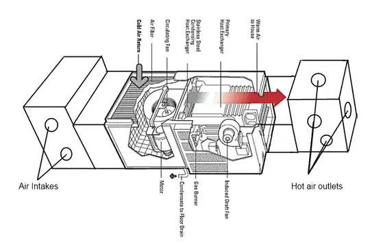

I have a Lennox G40UH(X) series furnace, which is installed in our attic (We have a single-story house on a slab). Because the furnace is installed in the attic, it is "laying down" on its side, and the incoming air is piped into what would be the bottom of the unit if it was standing up. We have intake vents in almost every room of the house (small vents, about 12" long by 8" tall). These vents go up to the attic, and they're all routed into a big metal box which is appears to be welded to the bottom of the furnace.
Because this is kind of hard to imagine, I mocked up a little image of my setup (this isn't my actual furnace, just a similar picture I found on Google):
furnace mockup
I have flexible ducts leading to the cold air intake "box" that is welded to the bottom of the furnace, and round flexible ducts leading from the hot air "box" to all of our vents (which are in the ceiling).
The problem I am having is that I can't see where to install a filter! I can remove the front panel and see the bottom motor, but there's no where to actually put a filter.

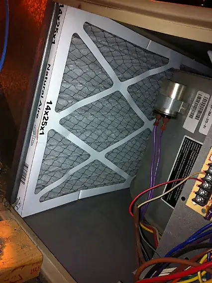

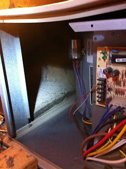

Update: As is usually the case with me, I put off worrying about the furnace until it started getting too cold here at night. I finally climbed up to the attic and took a good look at the furnace. There isn't any indication of where a filter should go, and no slot to slide it in or bar to hold it in place.
This is the air intake area - you can see the circulating fan on the right, behind the control board:
alt text
I put the filter along the bottom - a 14x25x1 fit snug across the whole side (bottom if it was standing up). I had to fold and bend the filter some to get it inside the furnace. The only thing that seems to hold it in place is the body of the circulating fan:
alt text

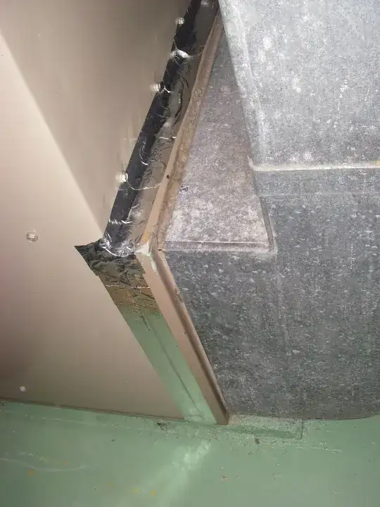

Usually the filter is mounted between all the return ducting and the furnace itself - potentially it is installed at a strange angle or covered up with tape or something. Here is a picture of mine, it's the darker colored piece the duct is attached to, with foil tape sealing it to the furnace housing.
pic of furnace filter housing

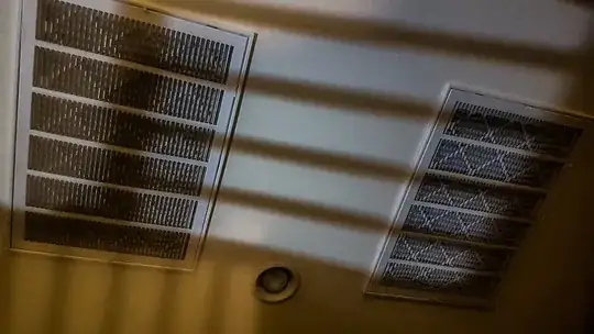

Just like the installation manual clearly says:
This unit is not equipped with a filter or rack. All G40UH(X) filters are installed external to the unit.
Which means it is installers responsibility to implement filtering system, Lennox has nothing to do with it. Here's the 2 rules of thumb (all, not just Lennox):
  1. If furnace is located in the basement then filter is placed at furnace between intake ducts and blower motor.
  2. If furnace is located in the attic then filter is placed at intake ceiling vents. enter image description here
If none of the above, then stick one any size that can fit in between intake ductwork and blower motor.
