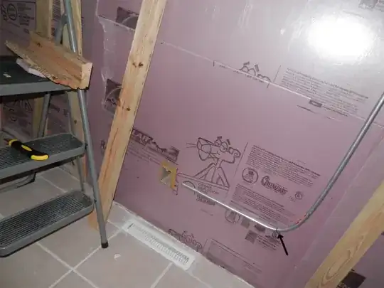

  • Still on the subject of emt conduit inside walls, I would imagine that given that the romex is not requried to be in conduits whilst inside walls then the fact that the romex is not inside a conduit all the way would then acceptable. As depicted below: ------------
    Emt conduit inside walls Emt Conduit in walls Wall+Rigid Insulation+Emt conduit
    – tk3000 Oct 24 '15 at 06:44
  • (CONT...) In this particular situation the electrical box is inside the concrete exterior wall since there is a cavity in the concrete wall for the box only (and no indentation in the walls for any wire), so I can not connect the emt conduit to the box (yep, I reamed the conduit and also using bushings whenever the wires exit the conduit). Also, I don;t want to drill larger holes in the joists (at least not with the exterior walls) for the conduit, so the conduit does not go all the way to the attic; and once in the attic the wire should travel in conduits unless very impractical. – tk3000 Oct 24 '15 at 06:45
